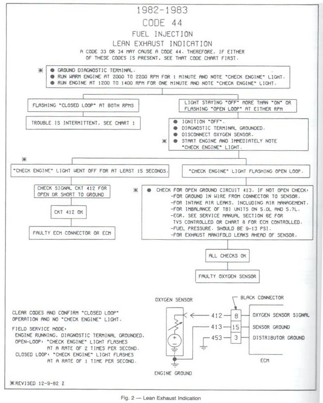

The  chart in Figure 2 has been revised and is being provided to update the following 1982 shop manuals:
  • ST-365-82 -- Citation/Celebrity, Pag. 6E2-44
  • ST-368-82 -- Camaro, Pg. 6E2-57
  • ST-364-82 -- Corvette, Pg. 6E-48
1982 Corvette Fuel Injection Diagnosis Chart Revision
