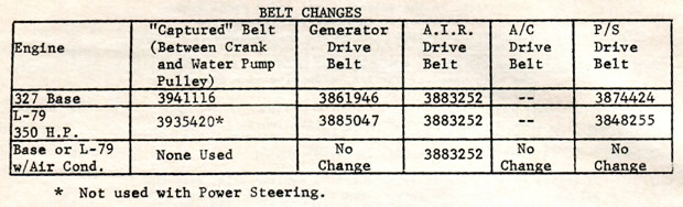

- New pulleys and drive belts installed to provide a higher numerical fan to water pump drive ratio, effective with Serial No. S412213.

- Install the new fan clutch assembly, #3857531, and the new pulleys and drive belts as outlined on the following charts:
On cars with L-79 and air conditioning (no power steering) it will be necessary to remove the water pump and water pump rear cover; and using an arbor press, push the water pump hub 1/8" further back on the water pump shaft. Be certain that the shaft is firmly supported on the press anvil to prevent damage to the bearing.
