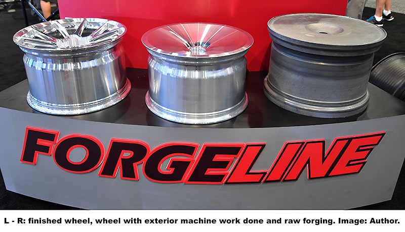

In 25 years, Forgeline has become one of the leading, high-end wheel makers in the World. One reason is their large portfolio of wheel designs. Forgelines come in two flavors: single-piece or “monoblock” and three-piece along with a wide variety of colors and finishes. The single-piece wheels are typically the lightest and are machined from one massive 110-pound forging. Forgeline three-piece wheels have spun aluminum rims and forged centers. Another reason for Foregline’s success is the wide variety of centers, rims and offsets the company has available in its three-piece line.

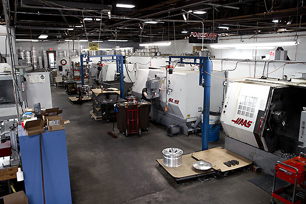

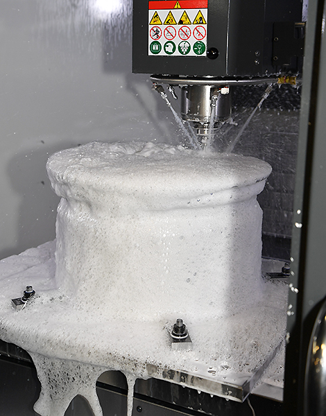

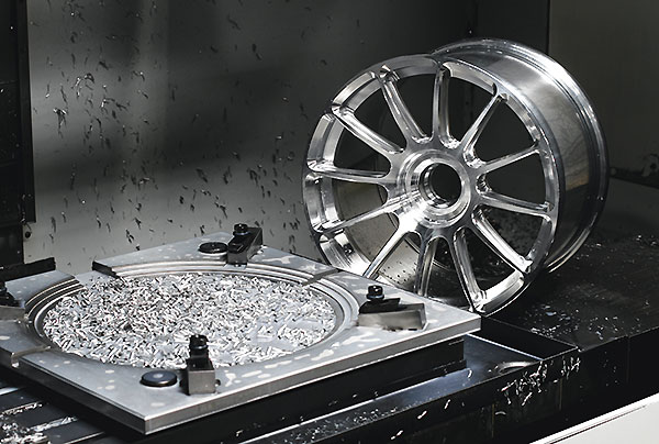

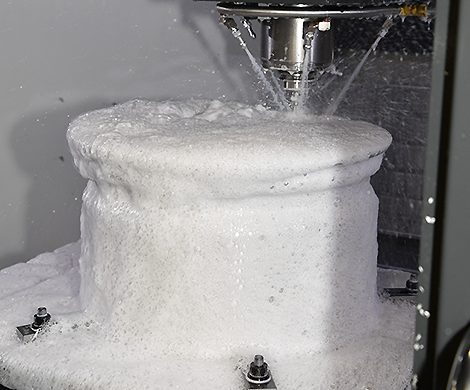

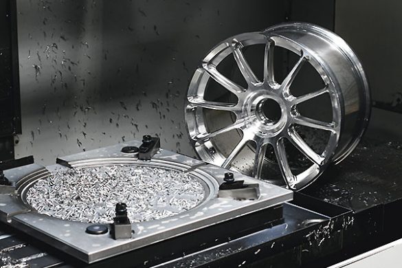

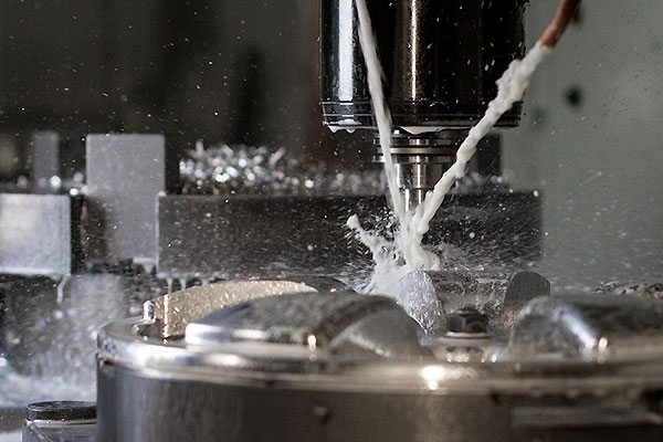

All machining operations at Forgeline are done in the company’s 11 Haas CNC lathes or CNC machining centers. Even the machines that make Forgeline wheels in the USA are made in America at Haas Automation’s huge factory in Oxnard, California. The Haas equipment is divided amongst two sections, one making single-piece wheels and the other making three-piece wheels. The single-piece production process takes a 110-lb forging and removes 85-90-pounds of material, all of which is recycled. To make a Forgeline single-piece wheel, It takes an hour on the CNC lathe and between an hour and four hours in a CNC machining center depending on what wheel design is being manufactured. Three-piece wheels take less time because the only on-site machine work is the center. Forgeline builds wheels to some tight tolerances. Maximum runout allowed for any of the company’s wheels is .020-in. With the Monoblock line, runout is rarely over .010-in.
From the machining department, wheel parts go into the grinding-and-polishing section where burrs and machining marks are removed and the wheels which are not to be powder coated are polished. Wheels which get powder coated are moved to Forgeline’s in-house coating facility. They bead blasted then are coated with whatever color the customer orders. Finally, they are baked for 20-minutes to cure the coating. Next comes wheel assembly and inspection. Last is packaging and shipping to the customer.

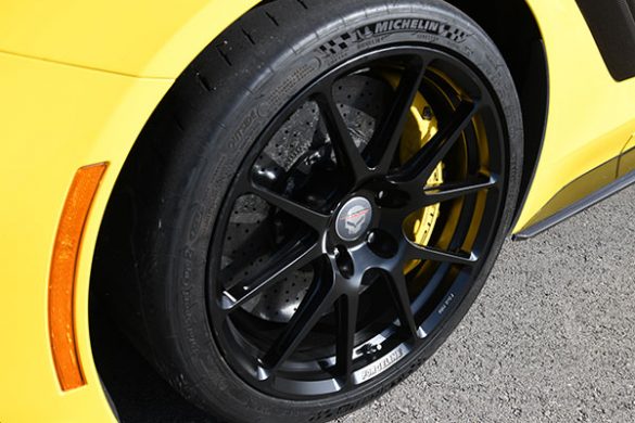

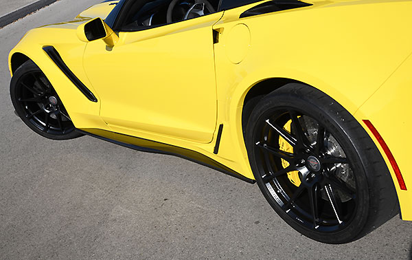

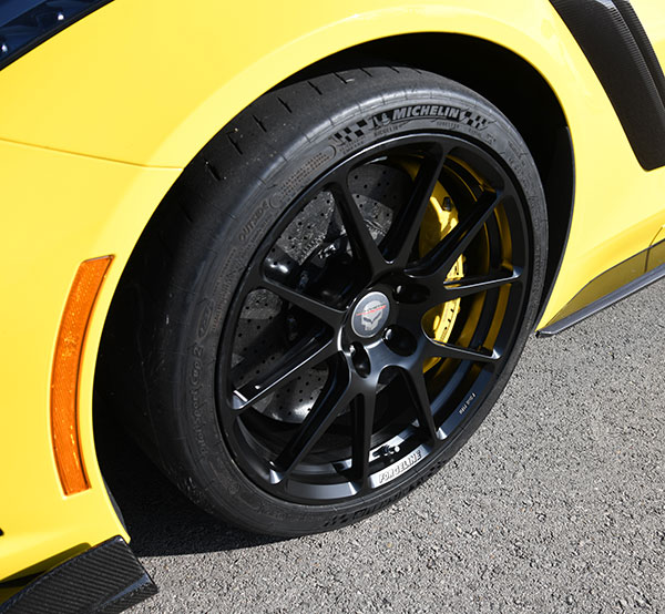

I have two sets of Forgeline GS1Rs on my 2012 Z06 and on my 2019 ZR-1. Both sets are monoblock wheels coated satin black to match the black trim on both cars. Their sizes are stock: 10×19 fronts and 12×20 rears on the C6 and 10.5×19, fronts and 12×20 rears on the C7. The GS1R has what Forgeline calls an “open lug pocket” which offer easier access to the lugs. For racers that’s an advantage on pits stops and, for we street drivers, it makes it easier to access the wheel nuts with an impact gun and not damage the lug pocket.
A Forgeline customer’s first clue that what he/she has purchased are a cut above what the rest of the wheel vendors sell is packaging. It is designed to minimize potential damage in shipping. Wheels are fitted with sponge-rubber rim protection rings, are sealed in plastic bags. and are put in specifically-sized, heavy-duty cardboard boxes.
If you have a scale, you can learn a key feature of a Forgeline wheel: less weight. A stock C7 ZR1 front wheel weighs 28.5-lbs and a stock rear weighs 33-lbs. The Forgeline ZR1 front weighs 20.3-lbs and the rear weighs 22.7-lbs, so there is about a 30% decrease in unsprung weight by going from a cast or spun-cast stock wheel to a monoblock Forgeline. That’s freakin’ huge.
Each wheel has a unique serial number machined into the aluminum. Also, there is an understated Forgeline logo and the words “made-in-USA”. Forgeline wheels will accept factory tire pressure sensors. Both sets of our Forgeline have OE GM sensors. Also, wheels can be ordered with standard Forgeline center caps or they can be machined for OE wheel caps. We have one set with the standard Forgeline caps and another with the optional factory “Corvette Racing Jake” caps.
I don’t have many miles on the second set of GS1Rs, but there are about 8000 miles on my first set. I live just outside the greater L.A. area and often drive into L.A. on its crappy freeways where pot holes. broken concrete and tilted slabs mean those Forgelines take some pretty significant impacts.  There are folks who have broken stock wheels on the poorly maintained highways and freeways common in California. So far, none of my Forgeline are any worse for wear after getting beat up on the freeway. That’s the sign of a premium monoblock aluminum wheel, but if you do have a minor “oopsie” with a Forgeline wheel, the company backs up its quality wheels with good service. If you have a wheel that sustained some chips, scratches or minor “road rash”, Forgeline’s “Refurbishing Department” can repair and re-powder coat wheels.
