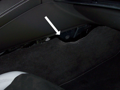

- Remove the Front Floor Rear Console Side Trim Panel – Right Side. Refer to Front Floor Rear Console Side Trim Panel – Right Side in SI.
- Pull back the carpet in the location shown to gain access to the A/C Evaporator Drain Tube.

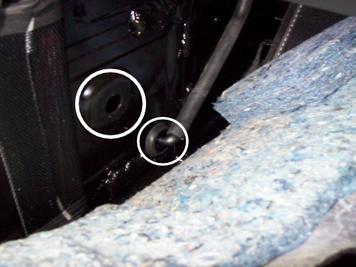

- The drain tube may be partially or fully disconnected from the body sheet metal as shown.
- If the drain tube end is fully disconnected, reinsert the drain tube end into the body sheet metal and press firmly to be sure it is securely fastened.
- If the drain tube end appears to be correctly seated in the body sheet metal, press firmly on it to confirm that it is securely fastened.

New 2023 C8 owner. Cold water from left of glove box area poured out on passenger. Left foot well area and tunnel wall carpet soaked. Found evaporator drain hose disconnected with tunnel hole end stuffed way up by glove box! Used this service bulletin to reinstall.
