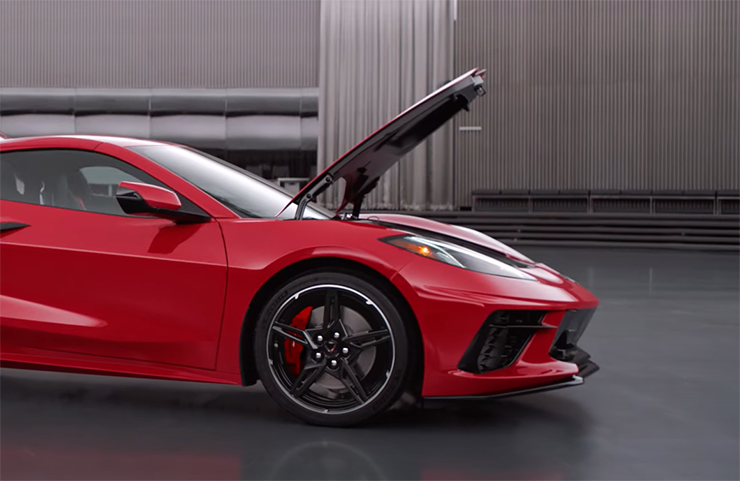

An Over-The-Air (OTA) update for the 2020 Corvette was sent out recently that changed the Body Control Module (BCM) calibration for opening the hood, or front trunk, (Fig. 2) using the Remote Keyless Entry transmitter (key fob) as well as the hood access button on the driver’s door. The software update changes the functionality of the buttons.

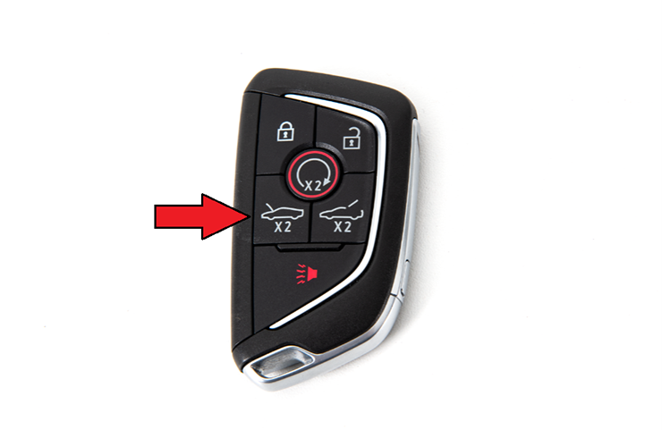

To open the hood after the update using the key fob, the hood release button (Fig. 3) must be pressed and released once and then pressed and held a second time. If the button is not held down on the second button press, the hood will not open.

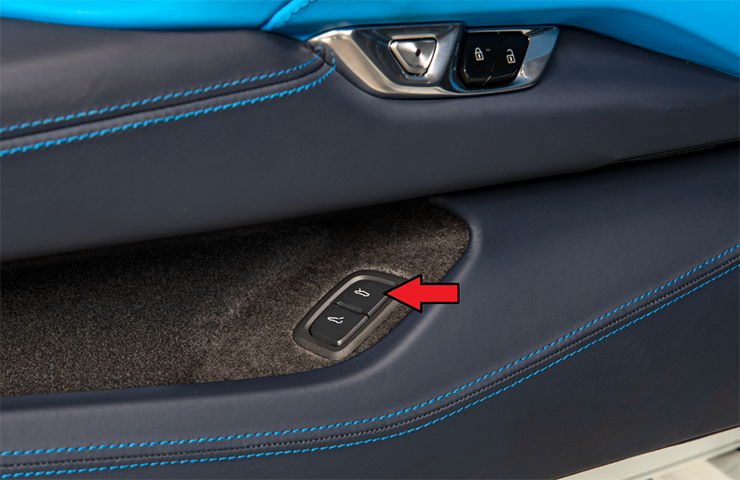

To open the hood after the update using the hood release button on the driver’ door (Fig. 4), the button must be pressed and held until the hood unlatches. The transmission also must be in Park. An audible sound should be heard when the hood latch releases. Quickly pressing and releasing the button will not actuate the hood release.
