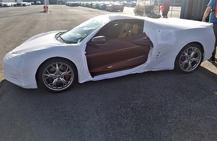

The exterior protective cover that wraps every 2020 Corvette (Fig. 20) to help shield the paint and body during shipping to the dealership should always be removed prior to vehicle delivery to the customer.
Fig. 20
Many GM vehicles come with protective coverings, foam blocks and other preventative measures applied before vehicle shipping to aid in vehicles being delivered in the best possible condition. The exterior protective cover must be removed completely in order to perform a proper pre-delivery inspection (PDI). The PDI includes time for the complete removal of the cover.
Vehicles should not be driven on public roads with any part of the cover installed on the vehicle. The protective cover is not approved for use on public roads.
In addition, the cover on the Corvette should not be given to the customer for use as a winter cover. It is designed for use as a shipping cover during transportation only. Once removed from the vehicle, it’s possible that any debris that gets trapped in the cover when removing or reinstalling it may cause possible damage.
