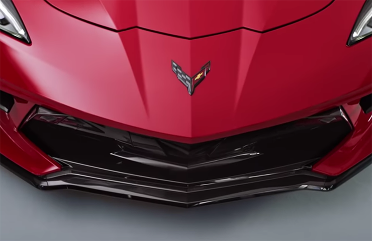

Ground Effects

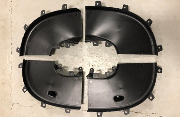

The RPO (Regular Production Option) ground effects are loose-shipped parts and will be delivered in the front and rear trunks. These include the front lower close-out panels. In addition, Z51-equipped vehicles will have a three-piece molded plastic front splitter (Fig. 26) and brake cooling ducts.
Fig. 26
LPO (Limited Production Option) aero components may include the one piece front fascia splitter, rocker moldings, and “big wing” rear spoiler. All LPO parts are shipped from the local ADIs. Please use care when installing the aero components.

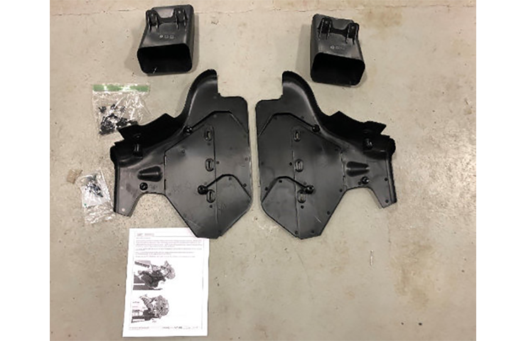

Brake Cooling Ducts
Z51 models include brake cooling parts. Install the brake cooling deflectors (Fig. 27), except the rear lower control arm brake cooling ducts.
Fig. 27
The rear brake cooling ducts (Fig. 28) that attach to the lower control arms are for track use only and should not be installed during the PDI. Driving the vehicle on the street with the ducts installed may lead to part damage from road debris or poor road conditions.
Fig. 28

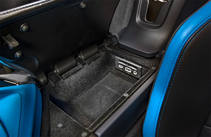

Navigation SD Card
The Navigation SD card is placed in the card slot in the rear section of the center console storage compartment (Fig. 29) at the assembly plant. As always, the SD cards are VIN-specific to the vehicle and cannot be swapped with other vehicles. Incorrect cards will result in the "SD CARD ERROR. The SD card is not valid in this vehicle for navigation." being displayed. Ensure the card is not locked.
Fig. 29
