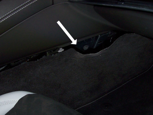

  1. Remove the Front Floor Rear Console Side Trim Panel – Right Side. Refer to Front Floor Rear Console Side Trim Panel – Right Side in SI.
    #N212327740: Service Update - HVAC Condensate Drain Hose Not Fully Installed - (Mar 10, 2021)
  2. Pull back the carpet in the location shown to gain access to the A/C Evaporator Drain Tube.

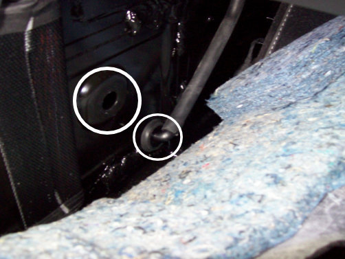

  3. The drain tube may be partially or fully disconnected from the body sheet metal as shown.
  • Shift the carpet back to the original location.
  • Reinstall the Front Floor Rear Console Side Trim Panel – Right Side. Refer to Front Floor Rear Console Side Trim Panel – Right Side in SI.
