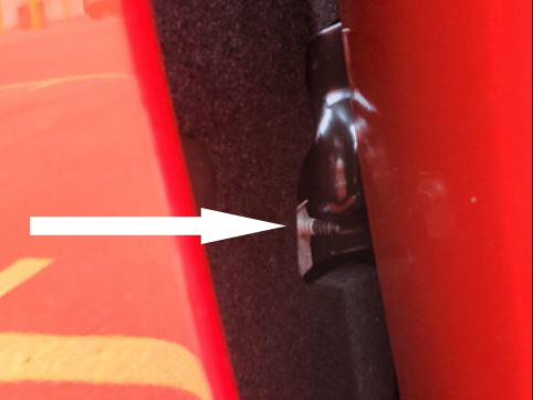

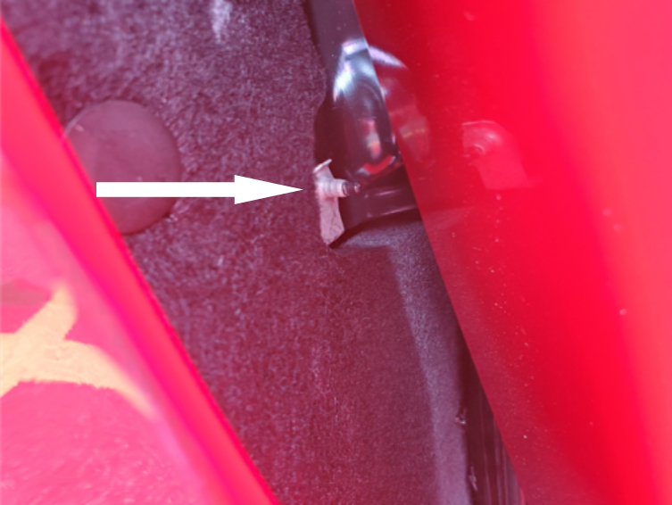

- Carefully open the left front door inspecting for any contact with the fender fastener. This fastener is located just below the door check strap area.
- Locate the threaded portion of the fender mounting bolt where it exits the nut.
- Count the number of threads showing.
- If less than 1 full thread is showing, no further action is required.
- If more than 2 threads are showing, proceed to step # 4.

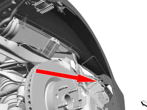

- Partially remove the wheelhouse liner to access the rear fender mounting fasteners. Refer to Front Wheelhouse Liner Replacement in SI.
- Locate and remove the center fender to body fastener as shown.
- Install the shorter service fastener. Tighten 9 Nm (80 lb in).
