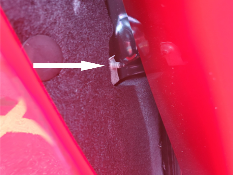

Certain 2020 model year Chevrolet Corvette vehicles may have a fender mounting bolt that is too long, and could come in contact with the door. |
Correction |
Dealers will inspect and replace the fender mounting bolt if necessary. |
