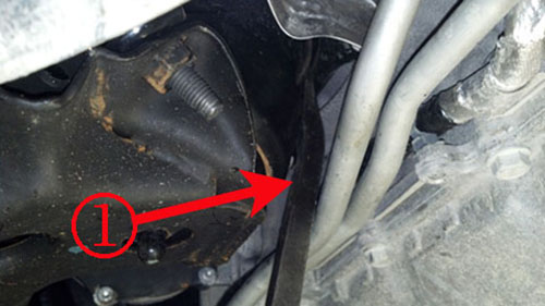

1. Loosen the engine mount bolts at the frame attachment points. (Fig. 15)
Fig. 15
2. Lift the engine slightly to take the load off the mounts.

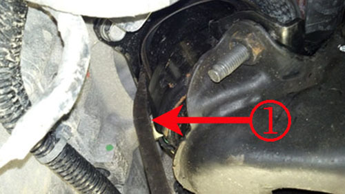

3. Use a pry bar to push the mount outboard as far as possible (about 1–1.5 mm) (Fig. 16, left engine mount; Fig. 17, right engine mount); torque the bolts while pushing the mount outboard.
Fig. 16
Fig. 17

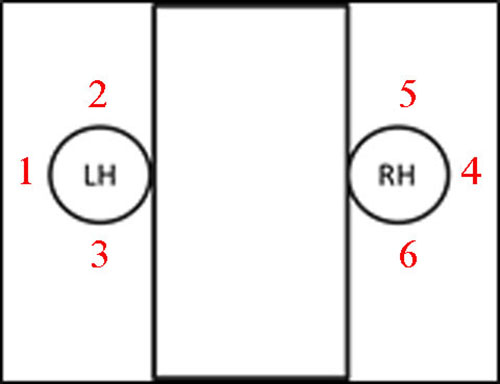

4. Tighten the center/upper bolt first, then front, then rear (Fig. 18). Complete this procedure for both left and right mounts.
Fig. 18
