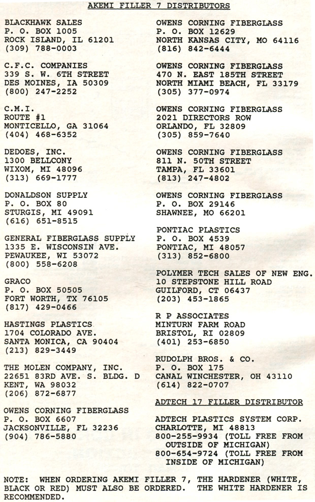

Some recommended repair/filler materials and a list of distributors are being provided.
STRUCTURAL EPOXY
A new improved material, a two-part epoxy, has been released for use as a structural adhesive. It is Fusor 320/322 and can be ordered from various distributors.
COSMETIC FILLERS
For cosmetic repairs, two fillers are recommended:
Akemi Filler7
Adtech 17
