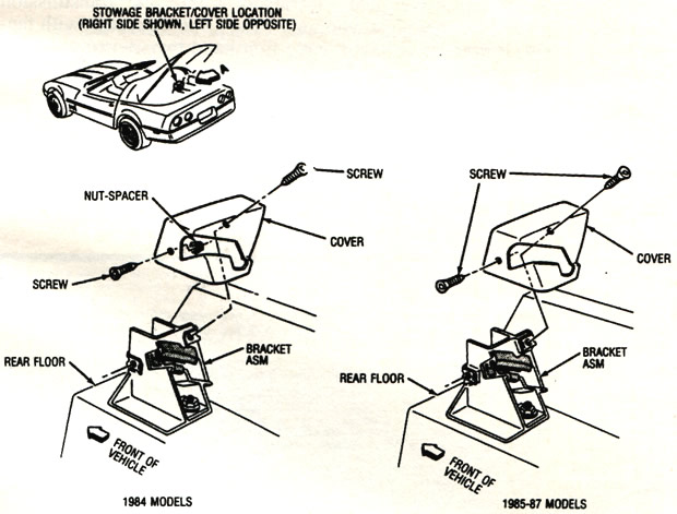

INSTALLATION INSTRUCTIONS
TOOL REQUIRED - MEDIUM PHILLIPS SCEWDRIVER
1985-1987 MODELS
  1. RAISE HATCH GLASS WINDOW.
  2. REMOVE THE TWO SCREWS FROM EACH COVER (SCREWS WILL BE REUSED).
  3. REMOVE THE ORIGINAL COVERS.
  4. INSTALL THE NEW COVERS AND TIGHTEN THE TWO SCREWS
1984 MODELS ONLY
  1. FOLLOW STEPS 1-3 ABOVE
  2. INSTALL ONE OF THE SCREWS THROUGH THE INBOARD SCREW HOLE IN ONE OF THE NEW COVERS (SEE ILLUSTRATION).
  3. PLACE A NUT-SPACER WITH THE WASHER SIDE TOWARD THE COVER ON THE PREVIOUSLY INSTALLED SCREW.
  4. PLACE THE COVER BACK ON THE BRACKET, BEING CAREFUL NOT TO SHARE THE NUT-SPACER OFF THE SCREW.  NOTE:  THIS NUT-SPACER IS REQUIRED TO SUBSTITUTE FOR THE MOLDED IN FIN-SPACERS WHICH WERE ONLY ON THE 1984 COVERS.
  5. RE-INSTALL THE SECOND SCREW AND TIGHTEN BOTH SCREWS, BEING CAREFUL NOT TO TIGHTEN THE SCREWS TO THE POINT OF DEFORMING THE COVER.
