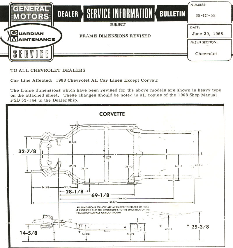

1968 Corvette: Service Bulletin: Frame Dimensions Revised Estimated Reading Time: < 1 Minute 1230 August 7, 2015 Chassis, Frame and Suspension 0 5.54K Below, is a Dealer Service Bulletin from G.M. of Canada regarding revised frame dimensions for the 1968 Corvette:
