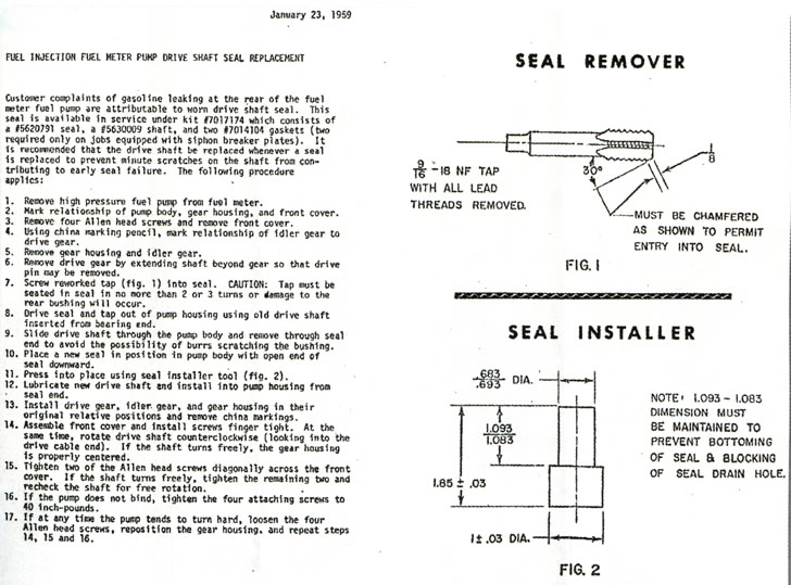

1959 Corvette: Fuel Injection Fuel Meter Pump Drive Shaft Seal Replacement
Estimated Reading Time: < 1 Minute Subject: Fuel Injection Fuel Meter Pump Drive Shaft Seal Replacement
Model and Year: 1959 Corvette
Source: Parts Kit Instructions
Date: January 23, 1959
