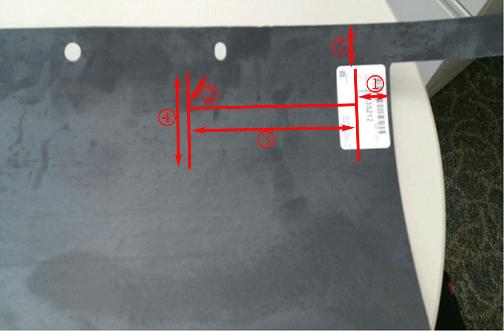

- Place the new front compartment air deflector on a surface that can be used to cut on. Mark the dimensions of 25.4 mm (1 in) (1), 19.05 mm (.75 in) (2), 152.4 mm (6 in) (3), 50.8 mm (2 in) (4) as shown in the illustration above and cut using a box cutter.

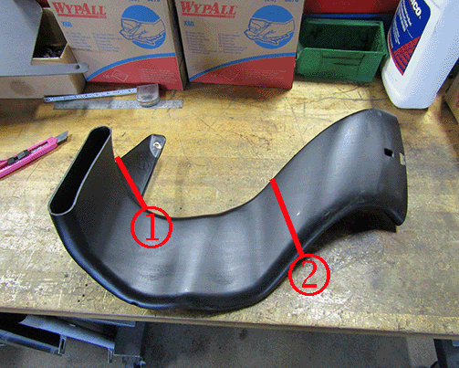

- Using a hack saw, cut the support arm off (1) and the duct after measuring 50.8 mm (2 in) (2) after the second bend.

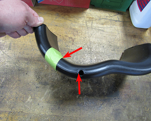

- Measure 50.8 mm (2 in) up from the top of the hole. Mark and cut using a hack saw.

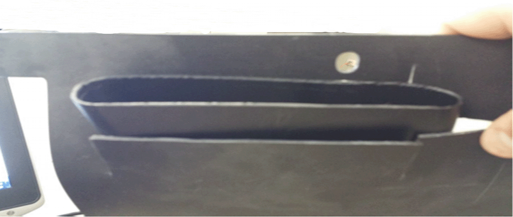

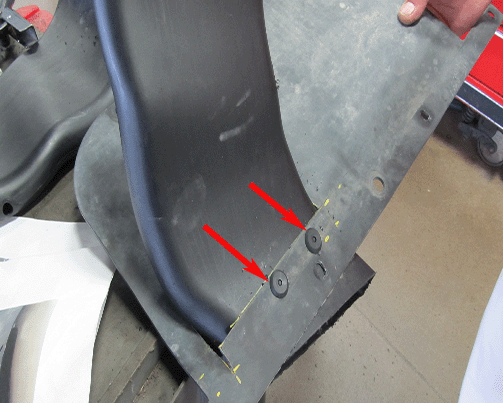

- Place the cut duct into the slot. Make sure it comes out of the slot 25.4 mm (1 in). Using a 17/64" drill bit, drill 2 holes through the deflector and duct and rivet together.

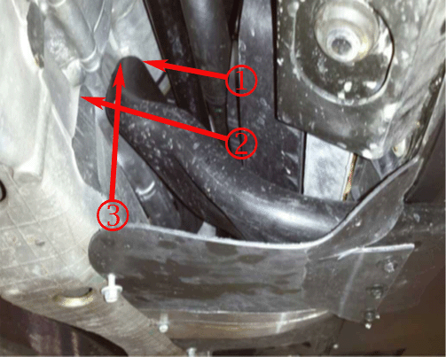

- Once the part is riveted into place, dry fit to the car to make sure enough of the duct is cut to allow it to sit between the steering motor (1) and the lower rack (2).
Note: This might require multiple cuts to the duct (3) and test fittings.
