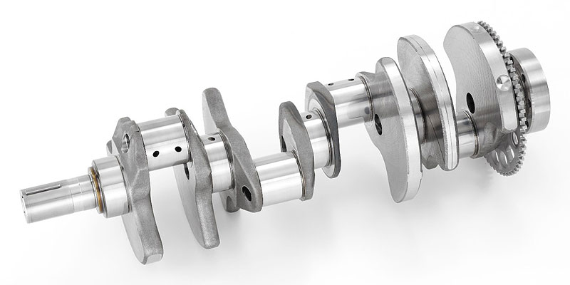

The LS7 introduced a forged steel crankshaft to the Gen 3/4/5 series of Small-Blocks. It was necessary for durability at the LS7's 1.18 specific output and because of its 7100 RPM rev limit. While the new LT1 can't rev to the LS7's lofty limits, it has nearly the same torque curve bellow 4000-RPM and .03 higher specific output. That mandated the same solution used for LS7–a steel crank. While we're on the subject of crankshafts, know that the LT1's main and connecting rod bearings are similar to the increased-eccentricity design pioneered by the LS7.
The new LT1's forged steel crankshaft inspired by that of the LS7.
Image:  GM Powertrain

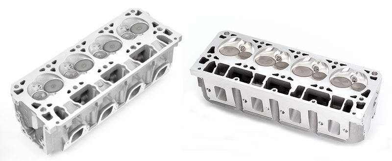

The new LT1's cylinder head (left), in some ways vastly different than that of the LS7 (right), did get the 427's valve angle, its valve spring height and the 1.8:1 rocker arm ratio.
While the LT1's direct injection head is mostly a new design, it's 12° valve angle, taller valve springs and 1.8:1 rocker arm ratio come directly from the LS7. Interestingly, serious engine wonks may recognize the new LT1 head's splayed valves as being inspired by the first LS7, a 465-hp, 454-cubic inch, Mark IV Big-Block V8 announced for the 1970 Corvette, but cancelled just before start of production. While no LS7 "rat motor" was put in a car, many were built for over-the-counter sale during the 1970s. All Big-Blocks had splayed (or "canted" or "porcupine" as some old-timers say) valves. With LT1, splayed valves are, as the late Yogi Berra once said, "...deja vu all over again."

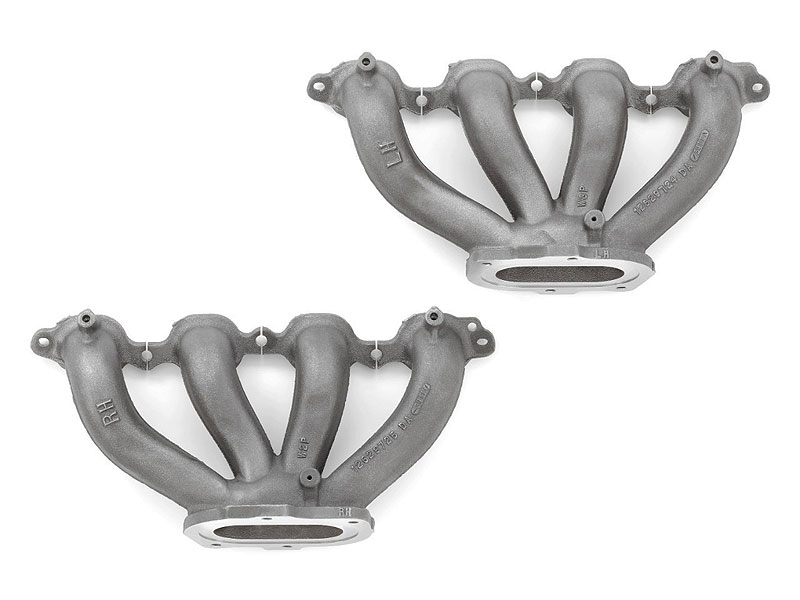

The LT1s exhaust manifold inherited much from the LS7 unit but, considering the numbers in which the LT1 will be made, it was more cost effective to make it in cast iron rather than fabricate it from stainless steel.
Finally, the LT1's cast iron exhaust manifold is a direct descendant of the LS7's ground-breaking, shorty-header style, stainless unit—right down to the "quad-flow" collector.
And what of the 2015 Z06's LT4? Well, the LS7's influence continues on that engine, too, in that LT4s use a titanium intake valve similar to the parts pioneered by the LS7.
The LT4 uses the same, LS7-derived exhaust manifold as the base C7’s LT1.
