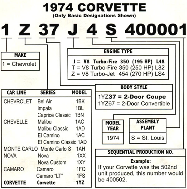

Vehicle Identification Number
1Z37J4S400001 - 1Z37J4S440606
Digit Definition
1st 1 = GM Division = Chevrolet
2nd Z = Series = Corvette
3rd/4th Body Style:  37 = Coupe, 67 = Convert
5th Engine Type:  J = L48, T = L82, Z = LS4
6th 4 = Model Year = 1974
7th Assembly Plant:  S = St. Louis, MO.
Last 6 digits Production Number starting with 400001 and up.
1974 Corvette VIN Identification
