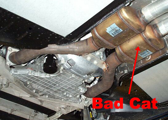

For the last couple of months, when driving our 2004 ZO6 LeMans Edition, I’d been getting a regular MIL for DTC P0430 which is a fault with Bank 2 cat efficiency. With HPTuners’ VCM Scanner app running on my Panasonic ToughBook, I could easily see that the Bank 2 Sensor2 signal was starting to mimic the Bank 2 Sensor 1 signal. When I swapped the sensors side-to-side, problem showed up in the Bank 1 Sensor 2 signal. That pretty much decided the issue–the Bank 2 cat was bad, so I began looking at new cats.

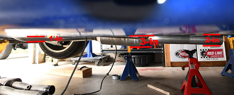

I lifted the MagnaFlow direct-fit cat set into place, supported it with a jack stand, slid the manifold flange rings in place, then installed the exhaust manifold flange nuts and bolted the cats’ center support to the pad under the rear of the clutch housing. Right away, the installation didn’t look right. I crawled out from under the car and looked at the side view. The two cats were hanging down 3-inches lower than did the stock cats. “WTF?” I wondered.
Let me digress…I didn’t select the MagnaFlow part only because it was made in CA. I emailed MagnaFlow’s media rep, Richard Waitas, and asked for some information about the part. Turns out Waitas is a C5 ZO6 owner and assured me that ground clearance would not change in a practical sense and that 12 years of cat technology advances and MagnaFlow’s mandrel-bent pipes could improve performance.
So, back to looking at the system hanging down 3-inches at the cats and 2 ½ inches at the cat’s rear connection. Ground clearance? Not.
MagnaFlow Direct Fit Catalytic Convertors for C5 Corvette ZO6
I should add that this MagnaFlow cat set is actually not a direct fit because, if you put it on a car with a stock exhaust, you’ll have to cut the last couple feet of the stock exhaust off and weld or clamp it to the rear of the MagnaFlow cats because they’re about two feet short and lack the bolt together muffler connections. Since I had previously cut off the rear of the stock cats and replaced that with the CORSA X-pipe rear section, I’d be ok. Well…except for the fact that the rear connection was 2 ½-inches lower.
If this had been a quarter or half an inch low, I’d would have just gotten out my hydraulic jack and a block of wood and “bent” the system a little to get it up higher, but I wasn’t going to be able to fix such a huge misfit, so I removed MagnaFlow’s so-called “direct fit” set of cats.
