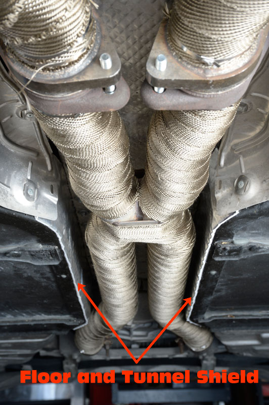

Recently, I used Floor and Tunnel Shield II on a 2012 Corvette Z06 as a thermal barrier between the driver side catalytic converter and the brake lines running along the driver-side frame rail. I also used it on the passenger side to protect the starter motor. Finally, I used two long strips of it on the sides of the transmission tunnel to reflect heat radiated by the exhaust system mid-section.
