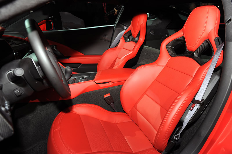

Heated and Ventilated Front Seats Inoperative with Remote Start
Expires with Base Warranty
MODELS: 2016 Chevrolet Corvette
Equipped with Automatic Transmission (RPO M5U) and Heated and Ventilated Front Seats (RPO KQV)
PURPOSE
This bulletin provides a service procedure to reprogram the body control module on certain 2016 model year Chevrolet Corvette vehicles equipped with an automatic transmission (RPO M5U) and heated and ventilated front seats (RPO KQV). While the engine is running during a remote start, and the remote start heated and ventilated seat feature is turned on in the vehicle personalization menu, the heated and ventilated seats may not activate.
