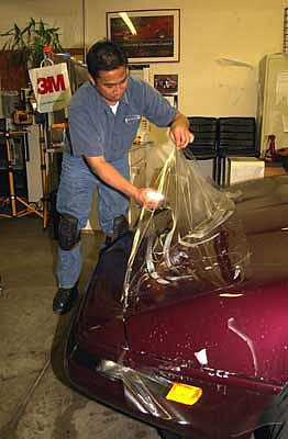

C4 Transparent Bras which include film on the front of the hood come with specific Scotchcal sections that go on the headlight buckets. Image: Author |

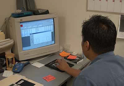

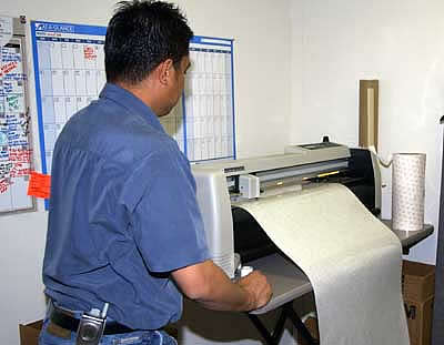

Back in the late-’90s, 3M developed the idea of marketing die-cut sheets of Scotchcal on an aftermarket basis for use on impact prone parts of a car’s exterior. As computer-controlled cutting of the film allows mass-production of a bra which is a specific fit to each car, a lot of the labor involved in fitting a car with Scotchcal on an aftermarket basis was eliminated. As the product is difficult to apply properly, 3M initially sold the product through factory-authorized and trained installers. One of the first businesses in the West to get into into selling Scotchcal for auto bras was Envisage Design Labs of Torrance, California. Envisage calls its product the "Transparent Bra."

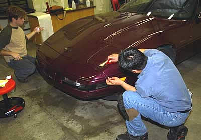

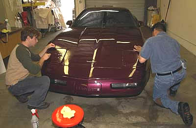

I undertook a real-world test of a Transparent Bra with my 1995 Coupe. The car’s paint is not seriously damaged, but it shows the car’s 67,000 miles with a fair amount of chips on the nose and the hood. I took the car to Envisage Design Labs to have it install die-cut Scotchcal to the nose, the forward part of the hood and the forward facing surfaces on the side-view mirrors. My intent in having this done was to prevent further deterioration of the car’s finish due to stone impacts and other "pepper spray" (as Envisage’s Daniel Cook calls it) which you get during highway driving. I was amazed to notice that, once the Transparent Bra was installed, most of the smaller existing chips and mars disappeared. That, alone, is worth the price of the installation.
A week after I had Envisage apply the Scotchcal, I took the car on the 50th Anniversary Corvette Caravan. In fact, I was assigned the honor of leading the Southern California Caravan from California Speedway in Fontana to Elk City, Oklahoma where we handed the group over to the Oklahoma Caravan leader. Driving the Goodyear/Flowmaster/MSD SoCal Caravan Lead Car, I gave the Transparent Bra a difficult, 4687-mile test over a two-week period. This product’s performance was exceptional. During a close inspection of the Bra while washing the car after the long trip, I noticed only one new mar to the area Envisage applied the Scotchcal and that was from a pretty big stone. In fact, my fiance, the Fairest Sandra the Red, remembers us getting hit with that rock, kicked-up by a truck ahead of us, as it bounced off the front of the hood, then nailed the windshield in front of her, taking a small chip out of the glass. Other than that, you couldn’t tell the front end was on a car that had been nearly 5000 miles.
There are two characteristics of a Scotchcal Paint Protection Film which some, who are extremely sensitive to the look of the exterior of their vehicles, might question. First, once applied, when viewed from certain angles and in certain lighting conditions, the Film has a slight texture to it--sort of paint which is slightly "orange-peeled". Also, if you apply Scotchcal to a large, relatively flat surface, such as the front of a hood, there will be a line at the edge of the Scotchcal which is visible from certain angles and in certain lighting. I did not find these two qualities objectionable considering the significant improvement in appearance compared to a traditional auto bra and that the product protects my front end.

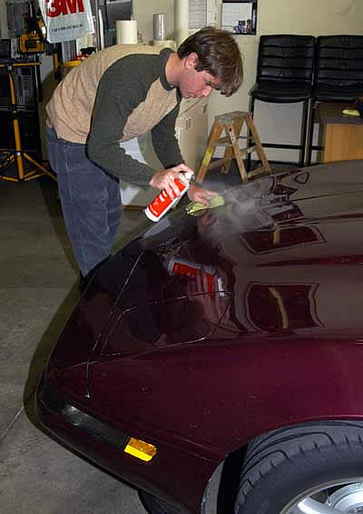

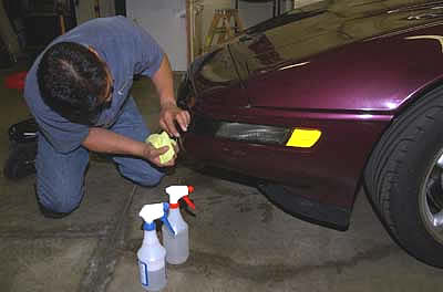

There is one aspect of Scotchcal Paint Protection Film that some hardcore DIYs might find unfortunate. In some information 3M has available on Scotchcal and in several conversations I had with authorized 3M Applicator, Envisage Design Labs, I learned Transparent Bras are really not a DIY product. While some 3M retailers sell Transparent Bras as DIY "kits", after watching Envisage apply the product to my car, I agree with 3M and Envisage: it’s definitely a job a DIY needs to carefully consider. Unless you have the correct tools, cleaning solutions and experience applying semi-permanent, adhesive films to surfaces with complex shapes, I’d leave installing Transparent Bras to professionals. Proper pre-installation cleaning is critical. Application to small-radius curves and compound curves is difficult. If you make a mistake, repositioning the Scotchcal is impossible unless done soon after the initial installation and, even then, special measures must be taken prior to installation to facilitate any repositioning. Once the adhesive has begun to cure, removal in an attempt at repositioning damages the Scotchcal.
