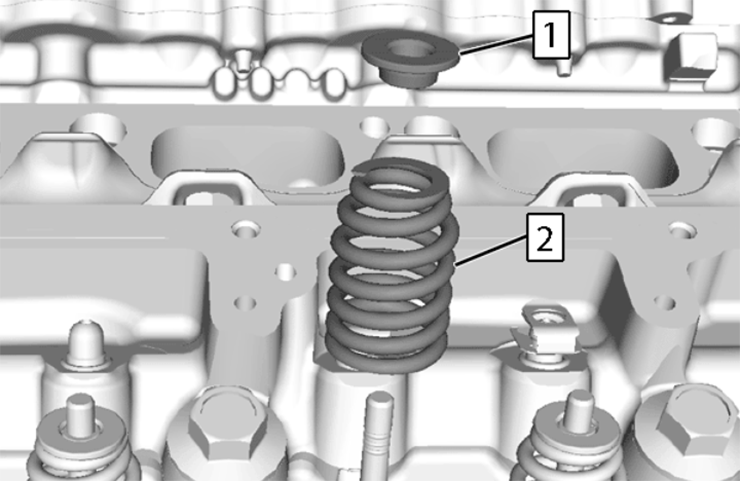

On 5.3L and 6.6L engines (RPOs L82, L84 and L8T) built from June 1, 2020 to October 7, 2020, if cylinder leakage is not observed, replace only the affected valve spring. (Fig. 13)

Fig. 13
If there is cylinder leakage in the engine, perform further diagnosis to determine the extent of the engine damage and the correct repairs required.
