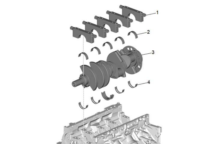

If these engine conditions are present, check for crankshaft bearing failure or a damaged thrust bearing. (Fig. 8) There are several items to inspect to determine if bearing failure has occurred.
Fig. 8

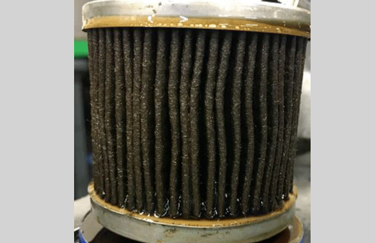

Begin diagnosis by inspecting the engine oil and filter for bearing material or excessive metal debris. (Fig. 9) Pouring the oil through a white shop towel may be helpful.
Fig. 9.
TIP: There may be light glitter in the oil from the manufacturing process if the engine has not had its first oil change. In this case, further engine inspection is necessary.
Remove the engine oil pan for further inspection of the crankshaft rod and main bearings if bearing debris has been identified.

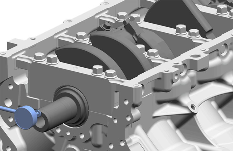

In addition, if material is found in the engine oil, measure crankshaft end play following the appropriate Service Information. (Fig. 10) If there is not excessive crankshaft end play, remove the engine accessory drive belt and run the engine again. If the noise is eliminated, check the accessory drive belt-driven components for possible issues.
Fig. 10
