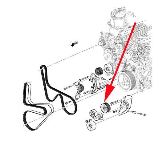

Customers may comment on a Scraping or Moan Noise heard best when the engine is idling |
Cause |
Supercharger Idler Pulley Assembly |
- Correction
If the vehicle falls into the VIN’s listed above Replace Idler pulley Assembly – P/N 12668046
