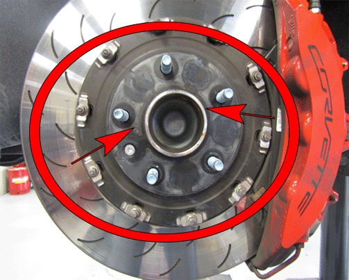

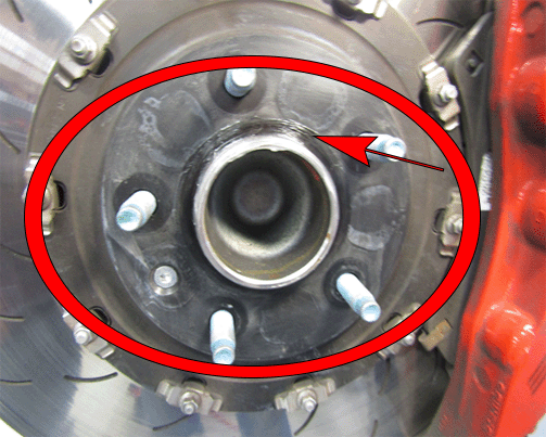

- Clean the wheel mounting surface of the brake rotors, or sometimes referred to as the brake rotor top hats, as follows:
- Using 3M red Scotch-Brite 7447 pad or equivalent with approved brake cleaner (ex. Part number 19370705 (U.S.), 88901247 (Canada)), wipe the wheel mounting surface of the rotor (brake rotor top hat) and the wheel pilot at the center of the rotor, removing any residual grey or black material that has accumulated on the rotors.
Note: All cleaning must be done by hand. DO NOT use pneumatic or power tools.
- Using Super Lube paste, P/N 12371287 (in Canada, 10953437) or equivalent, apply a light coat around the center pilot of the hub ONLY.
