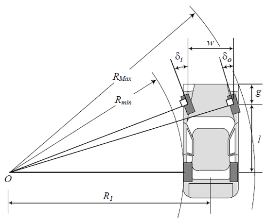

- Imperfect Ackermann Steering Geometry and Sticky Tires – Tire chatter occurs when the car is turning at low speeds and tight steering angles because the left and right front tires do not follow the same arcs. The Corvette’s sticky tires then build up force as they turn on the different arcs until eventually one or both tires slip.
Ackermann steering geometry is shown in the diagram below. On a car with perfect Ackermann, the inside tire angle (Si) and outside tire angle (So) follow the same arc. On a Corvette Stingray, at large steering angles, they do not follow the same arc.
Why Do The Tires Not Follow the Same Arc?
- It allows the car to be built to package larger brakes, reasonable wheel offsets, and a wider stance. These allow superior handling and performance and makes room for the large V8 engine.
- The Stingray has a tighter turning radius than the previous generation Corvette by two feet. This tighter turning radius makes the tire angles more extreme. While this may increase tire hop it affords the driver greater low speed maneuverability.
