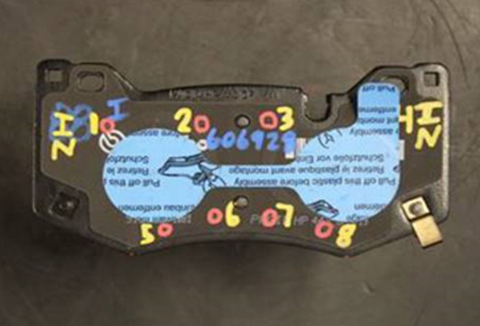

If the customer describes a brake noise coming from the vehicle, perform bulletin 17-NA-040 as described. When removing the front brake pads on a Z51-equipped vehicle, the servicing technician should notice that there is a piece of double-sided tape that secures the front brake pads firmly to the caliper pistons. See the photo below as an example. The blue area is this peel-and-stick double sided tape.

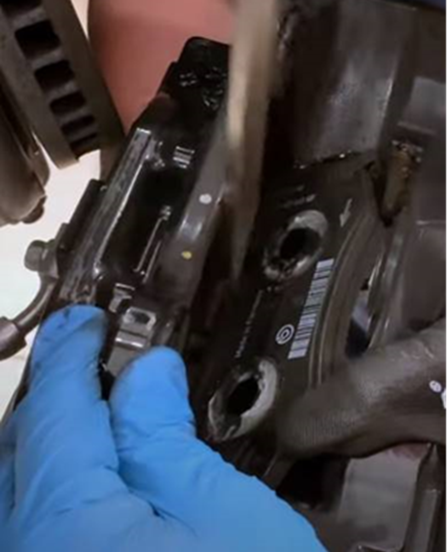

To apply the paste correctly, the pads must be removed from the calipers. See the photo below for an example of what the front brake pads look like once they have been separated from the caliper pistons.
This is normal when the front pads have been removed. When this has been done, remove as much of the remaining tape residue as possible. Then, apply the copper paste as directed in the bulletin. Once the copper paste has been applied correctly to the front brake pads, simply reinstall them into the calipers. There is no need to replace the front brake pads during this service because of the double-sided tape.
