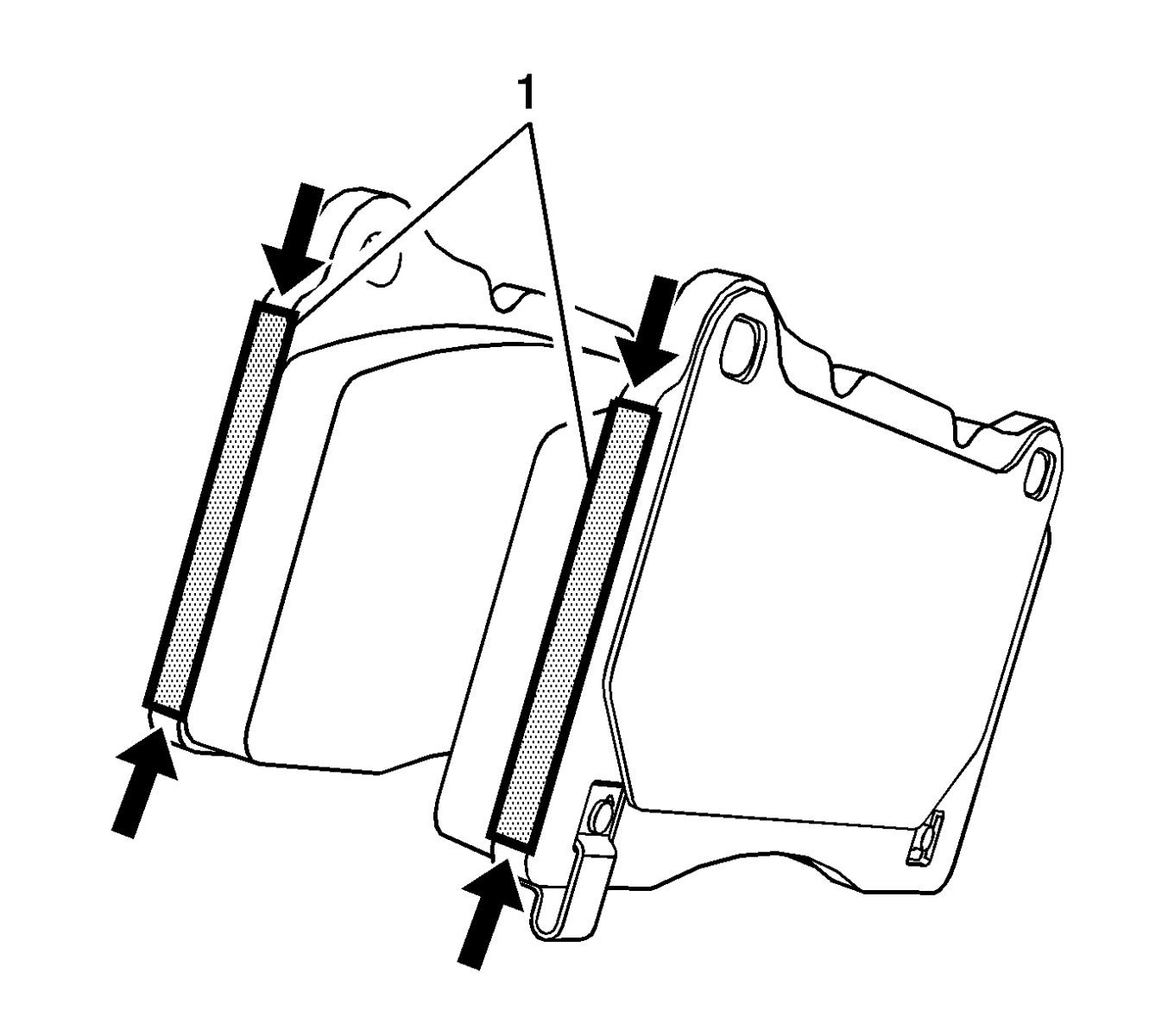

Apply a coat of copper paste to completely cover the pad backing plate abutments on each end. The paste should not extend onto the friction material. Follow the instructions listed below.

(1) Abutment Area

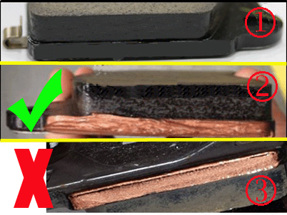

(1) Cleaned Abutment Area (2) Correct Amount of Copper Paste (3) Incorrect Amount of Copper Paste - Remove the front disc brake pads. Refer to Front Disc Brake Pads Replacement in SI.

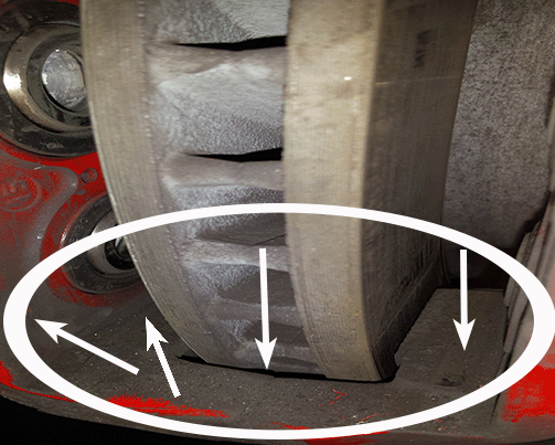

- Using acrysol Kent Industries Part# P2005 or equivalent, wipe clean both ends of the abutment area on the front pads and calipers.
- Apply approximately 0.10 g (0.0035 oz) of copper paste to each end of the disc brake pad abutments that contact the brake caliper bracket.
Note: Avoid a light apply of the paste as illustrated above.

(1) Abutment Area

- Using acrysol Kent Industries Part# P2005 or equivalent, wipe clean both ends of the abutment area on the front and rear pads and calipers.
Note: Ensure that the ends of the brake pads have enough copper paste applied, if not, could result of the noise condition returning.

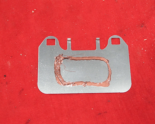

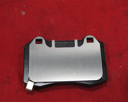

- (Chevrolet SS Models Only) Apply a rectangular shape of copper paste in the center of the spacer before installing on the back of the pad.
Note: DO NOT replace brake pads for this condition.

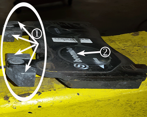

Important: DO NOT remove the silencers (1) on the pads.
Important: Always replace brake pads with Brembo GM OEM pads (2). Aftermarket pads could result in the braking performance changing in many ways.
