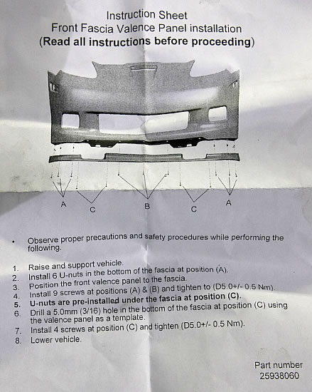

2009 Corvette ZR1: Front Fascia Valence Panel Installation Estimated Reading Time: < 1 Minute 151 July 6, 2014 2009 - 2013 Corvette ZR1 0 2.27K Below are the installation instructions for the carbon fiber front fascia valence panel on the 2009 ZR1:
