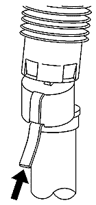

In order to remove the stuffers, follow these steps:
- Lift the vehicle, allowing the wheels to hang free. This will extend the dampers.
- At the front, steer the wheel in the direction away from the side you're working on.
- Reach up from below, behind the tire. At each wheel, compress the rubber dust boot.
Notice
After removing the stuffer, be sure to pull the dust boot down to cover the upper end of the damper tube in order to avoid damage to the suspension system.
- Pull the yellow tab to remove the stuffer. Discard the stuffer.
Important
The stuffers should not be reinserted for temporary transport, such as on a flatbed hauler. The stuffer is effective only if the suspension can be snugged down enough for the jounce bumper to contact the stuffer. This is generally not possible on a flatbed hauler.
