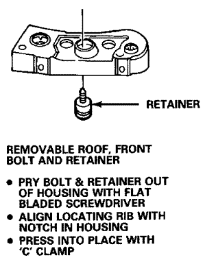

- Removeable roof panel
1. Rattle of front attaching bolts 1. Install new bolt retainers, when panel is stowed in rear. P/N 10 1 75804, see Figure 8.
Procedure:
1. Soak new retainers in warm water to aid in installation.
2. Remove roof panel and stow.
3. Remove upper trim covers at right and left latch areas.
4. Remove right and left sun visors, inside mirror and center garnish molding.
5. Carefully pry original retainer and bolt out of housing using a flat blade screwdriver or other suitable tool.
6. Install bolt in new retainer, align locating rib on retainer with notch in housing and press into place with a "C" clamp and socket.
7. Reinstall garnish molding, inside mirror, sun visors and upper trim covers.
Labor Operation Number: T1704 Labor Time: .6 Hour (Both Sides) Trouble Code: 92
2. Rattle if roof panel frame 2. Reinstall and glue plugs into filler plugs become loose. position with small amount of P/N 12345096* or 3M08011.
