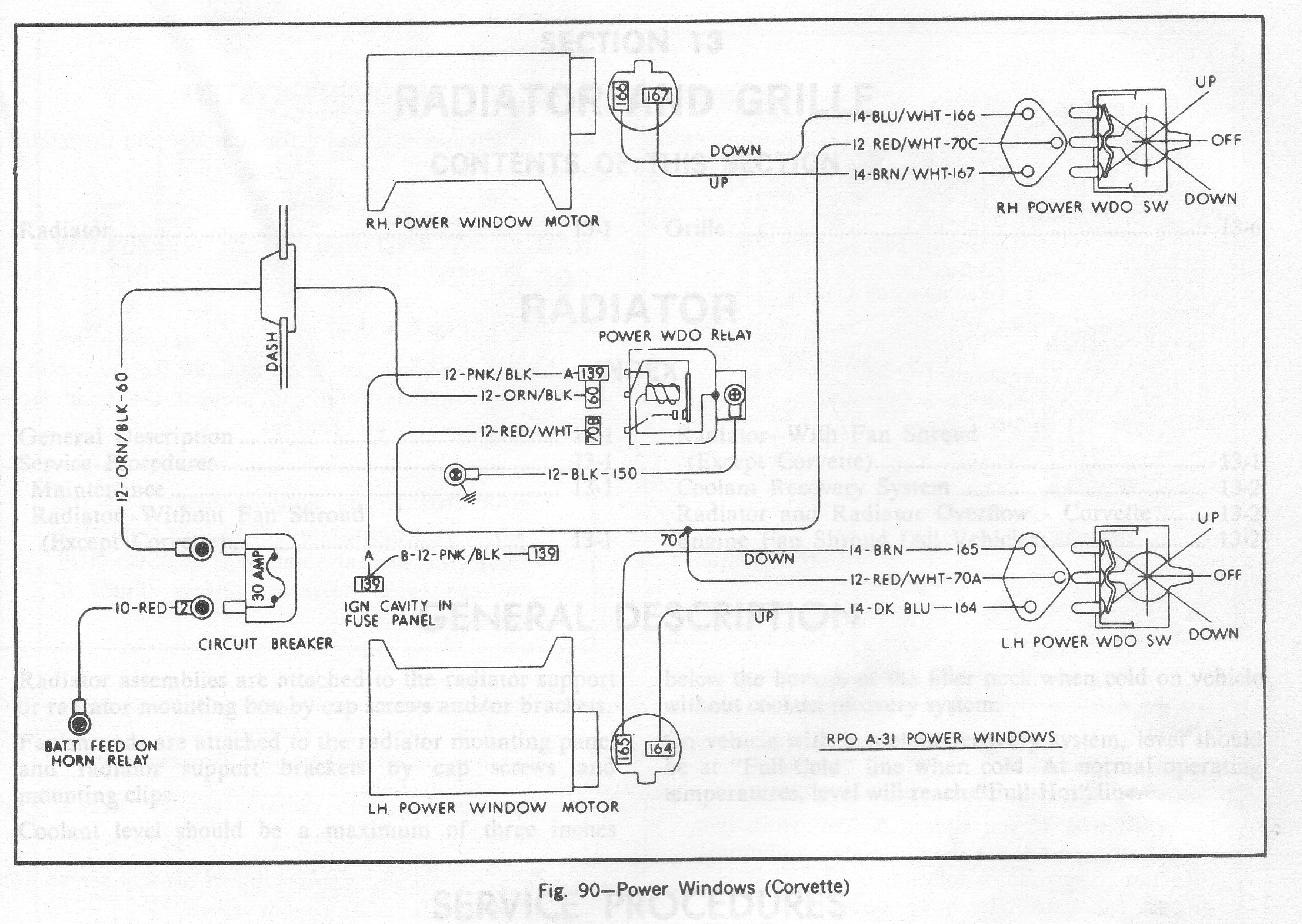

1973 Corvette: Electrical Schematic: Power Windows
Estimated Reading Time: < 1 Minute
Attached below is the electrical schematic for the power windows in the 1973 Corvette.
