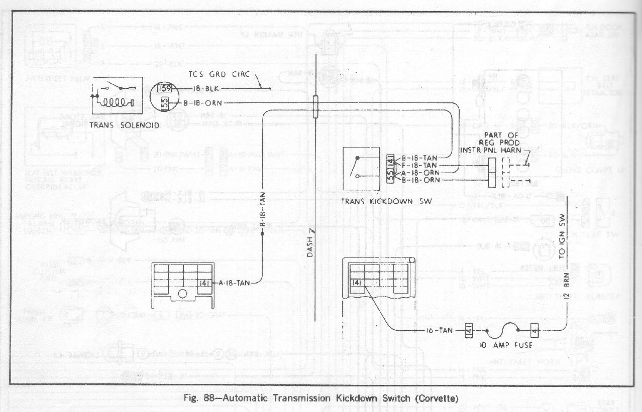

Attached below is the electrical schematic for the automatic transmission kickdown switch in the 1973 Corvette.
1973 Corvette: Electrical Schematic: Automatic Transmission Kickdown Switch
