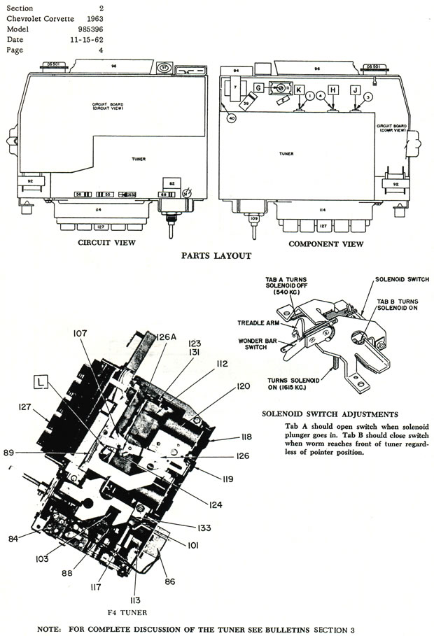

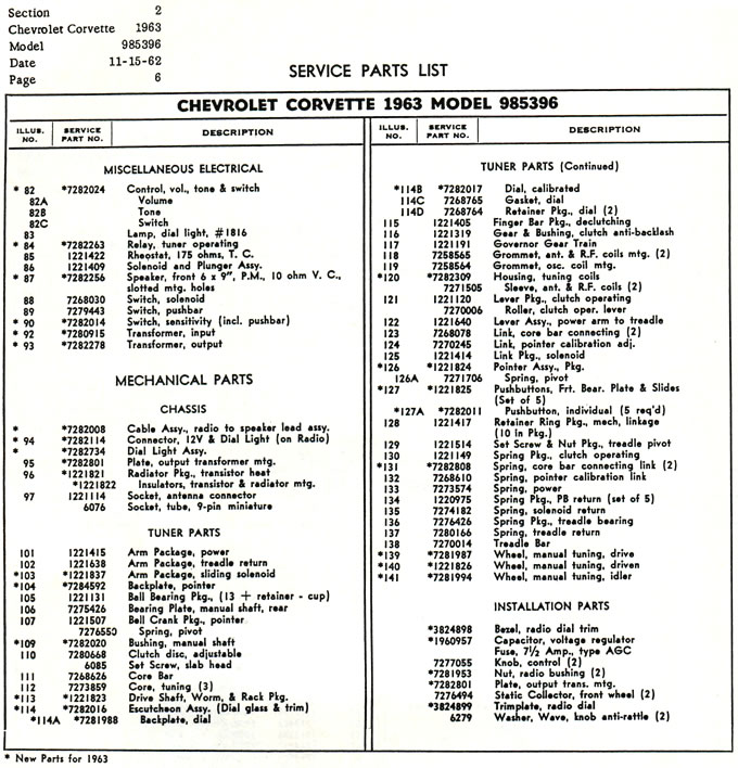

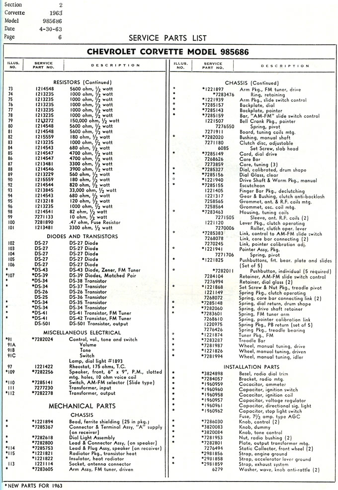

1963 Corvette: Delco Service Bulletins: Delco Radio Service Estimated Reading Time: < 1 Minute 1171 February 9, 2015 Electrical and Ignition 0 3.19K The following service bulletins from Delco apply to all 1963 Corvettes equipped with RPO #U65 - Signal Seeking AM Band Radio:
