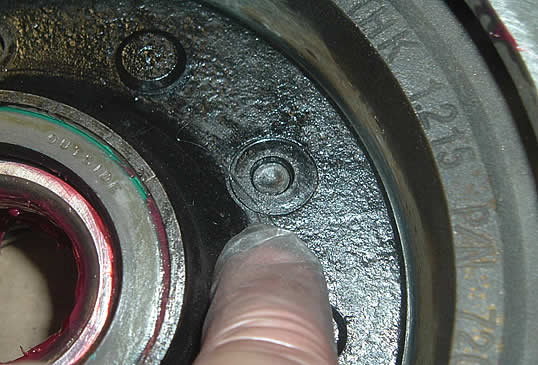

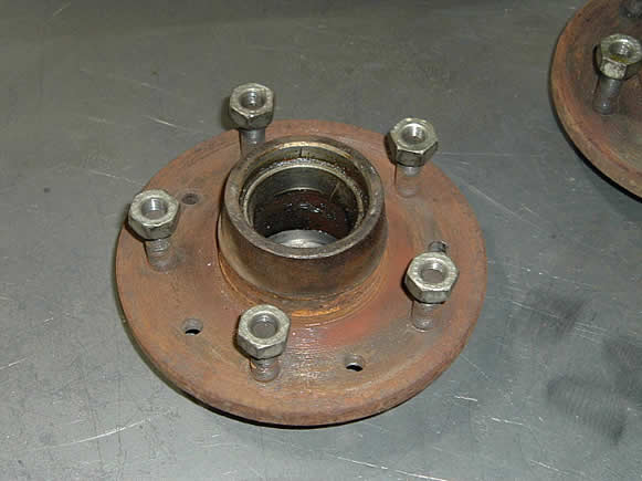

Here we have a rotor in typical used condition. Notice I already started on the rivets.

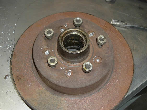

Here I have the rivets out and the rotor off. I drilled down just below the thickness of the rivet flange with a 5/16 bit. Then I use a cold chisel 90* across the head to cut it in half.

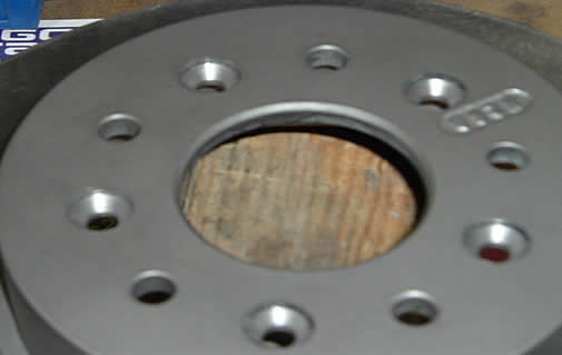

The rotor hat needs to be countersunk to use 3/8-24 socket flat heads.

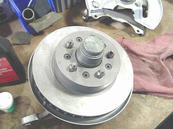

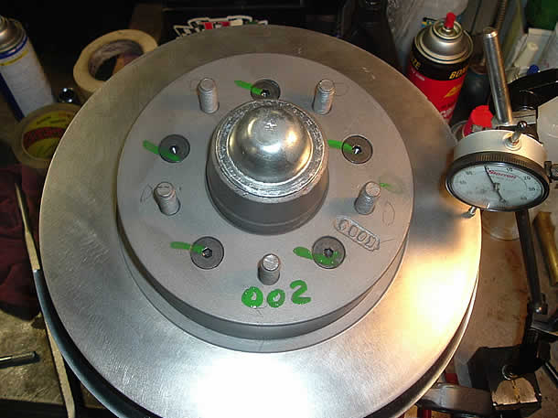

Here is my finished 72 assembly, look at the grease cap. It is the original GM one.

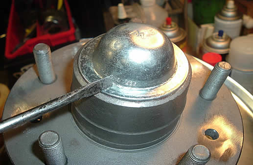

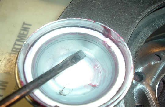

Here is the cap on the spindles I’m now doing. Not the same.
The cap’s inner radius is tighter. I wondered why the bearings were getting snug after I set them up and installed the cap. The cotter pin was hitting the narrow inside angle and dragging. I installed a new pin and fit it under the cap with no drag.

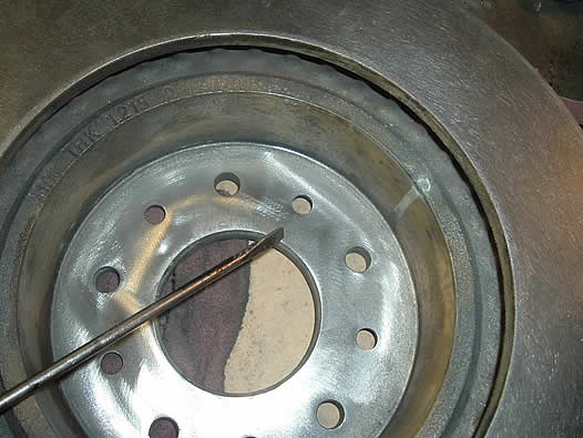

Regardless if new or used clean up and grind flat the area around all the holes. This is the mating surface on the rotor.
Notice the flat heads don’t protrude beyond the tapped hole.

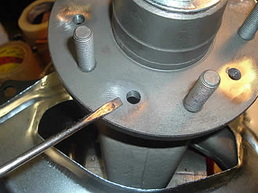

Here is the hub flange. Tapped 3/8-24 and the holes ground. Notice the turning lines still in the flange, there was no rust on this 35 year old part. The runout with the new rotor was .008" to start.

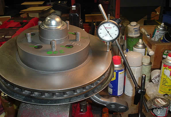

With the rotor bolted on and the bearings set to .001-.002 endplay I setup the indicator. I had to shim one location to get it just under .002" total runout. It’s closer to .0015" but I marked it at .002’.
Here is the finished job. The green paint witness marks the rotor to hub location.
