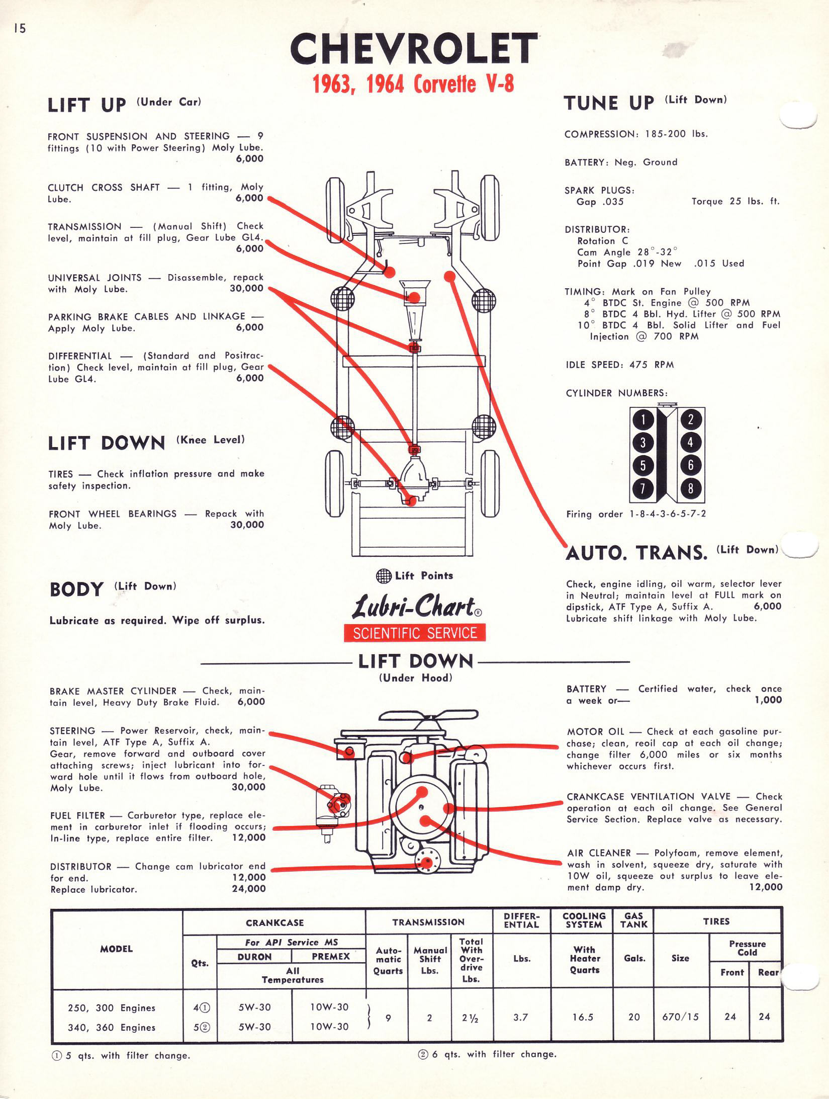

A chassis and powertrain lubrication chart for 1963-1964 Corvettes - document attached below.
1963 - 1964 Corvette: Lubrication Chart
