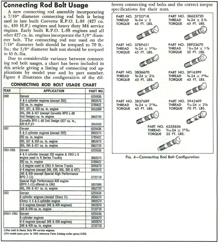

The connecting rod bolt usage information below applies to all Corvettes from 1956 to 1968.  This information was not in earlier shop manuals.
Subject:    Connecting Rod Bolt Usage
Model and Year:   1956 - 1968 Corvette
Source:  Chevrolet Service News
Page Number:   NA
Date:  August 1968
1956 - 1968 Corvette Connecting Rod Bolt Usage
