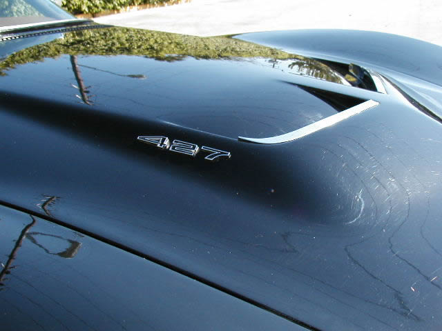

Click for larger image Exterior Emblems:
  • Model Years:  1968 - 1969
  • Description:
    • This hood with the 427 emblem was only used with the L36, L68 and L71 427ci engine options for 1968 and 1969.

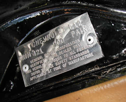

Click on picture for enlarged image. Trim Tag:
  • Description:  This contains factory ordered color and trim option codes.
  • Location:  The Trim Tag is located on the driver's door hinge pillar.
