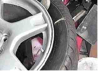

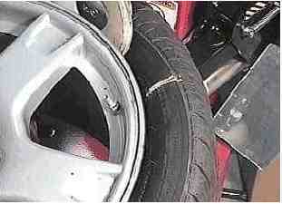

| 1. The high spot of the tire should be aligned to the lowest position on the rim to minimize runout and radial force eccentricity. |

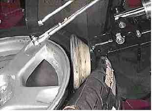

2. Lubricate tire and rim. Grasp tire shoulder with upper and lower rollers. |
| 3. Rotate wheel counterclockwise. Continue to increase roller pressure until tire stalls and rim index and tire index are aligned. |

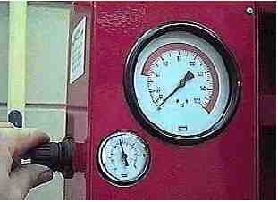

4. Dial in and preset the desired inflation pressure. |

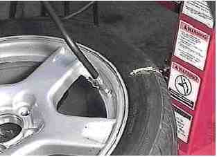

DANGER: If tire beads do not seat
below 40 psi, relubricate and retry.Tires requiring more than 40 psi MUST be placed in an inflation cage. |
| 5. Inflate tire and balance dynamically. |
