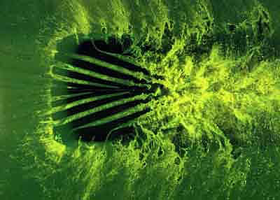

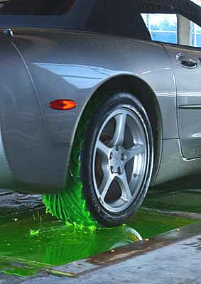

The most noticeable visual trait of the GS-D3 is the "V-TRED". In fact, vaguely similar tread patterns are seen on a few other brands of tires and are perceived by some as a fad or a status issue. In fact, the GS-D3’s tread is a critical part of this tires excellent wet performance characteristics. No doubt, this deep V tread works. On a number of occasions, driving at the speed limit or higher on the Interstates around the L.A. area, during heavy rain storms, I hit scattered spots of shallow standing water, some perhaps deeper than what was on Goodyear’s VDA. These new Goodyears were able to roll on though without any serious hydroplaning. As to why V-TRED works, I learned that at the "Glass-Plate" testing facility at Goodyear’s Proving Ground. You may have seen images of tires, rolling across wetted-down, glass plates. San Angelo’s Glass Plate facility is where Goodyear does that kind of test work. It’s not often that tire companies invite writers to visit the venues they use for this kind of testing, much less let them go down into the underground lab beneath the plate and watch their engineers at work, but Goodyear did that for this Corvette Action Center review. The actual plate is about 18-in. wide, 36-in long, 4.5-in. thick and covered by an .080-in. of water. The Glass Plate control system is designed to hold that water depth accurately as long as the wind is less than 2-mph. If the wind velocity is higher than that, no testing is conducted. After each run across the plate, automated equipment cleans off the plate and restores the water layer to the .080-in. depth. The plate itself is scientific-grade, optically-correct glass. The imaging equipment is digital and computer-controlled. Strobes are used to light the tire as it crosses the plate and the water is dyed green, which shows up best in a color image. While we were in the "Pit," a Goodyear test driver ran a C5 Coupe fitted with F1 GS-D3s over the plate a couple of times at 40 mph while I watched the test images get processed then looked at the results. Goodyear-supplied data accumulated at this facility for the Bridgestone Potenza S-03, the Michelin Pilot Sport and the F1 GS-D3. Typically, this data is taken at 2mph (which establishes a 100% footprint "baseline"), 40 mph, 60 mph and sometimes higher speeds, depending on the tire or the testing required. In this case, the data was for 2, 40 and 60 mph. At 2mph, obviously, all three had 100% of the footprint area retained on a pass through the .080-in water. At 40 mph, They varied from 88% area retention for the Goodyear and the Bridgestone to 91% for the Michelin. At 60 mph, things changed. The Michelin dropped to 61% of the area retained. The Bridgestone was at 64% and the Goodyear was at 67%. If you want to go fast in the wet, the best hydroplaning resistance in the ultra-performance tire market, right now, comes with the new GS-D3.
This tire’s improved resistance to hydroplaning comes from the V-TRED technology. Circumferential, water-evacuation channels, such as Goodyear uses on the Aquatred 3, wouldn’t work on a tire like the F1 GS-D3 because they’d degrade its dry-traction capability. The solution is long, sweeping grooves that are at an angle, but not as sharp an angle as seen on previous Goodyear performance tires. The V-TRED grooves extend more than three times the length of the tire contact patch. When the tire is rotating these grooves greatly enhance the flow of water to the outside of the tire’s tread, yet still put lots of rubber on the road. At one of Goodyear’s web sites, www.eagleF1.com, is an outstanding, graphical display of the V-TRED idea along with a lot of other pretty cool image stuff. You need the latest Macromedia Flash plug-in for your browser to view it.
