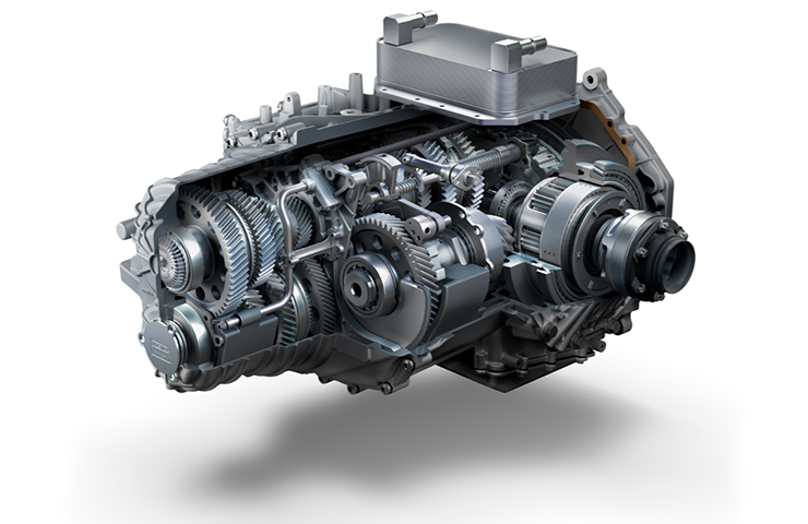

A Service Transmission message or a Service Engine Soon message may be displayed on the Driver Information Center of some 2020-2021 Corvettes equipped with the DCT TR9080 transmission (RPO M1L) (Fig. 18) along with DTCs P2838 (Shift Fork 2 Position Sensor Circuit Low), P2839 (Shift Fork 2 Position Sensor Circuit High) or P283A (Shift Fork 2 Position Sensor Circuit Intermittent).

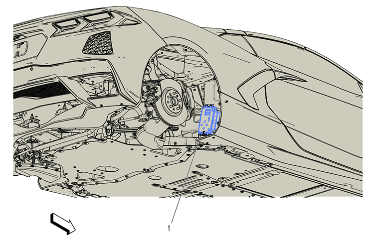

If any combination of these DTCs have set (current or in history), check circuit integrity on circuit 7812 between the Transmission Control Module (TCM) (Fig. 19, #1) and the transmission. Check the terminal tension as well as for a possible short to ground.

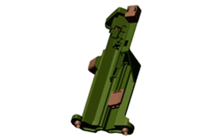

The Odd Sensor Module (Fig. 20) is located in the shift fork assembly and contains the transmission input shaft speed sensor – odd gears and the shift fork 1 position sensor and shift fork 2 position sensor. The TCM uses the output speed sensor signal along with the even and odd input shaft speed sensor signals to determine transmission line pressure, shift patterns, and the correct gear ratio.
