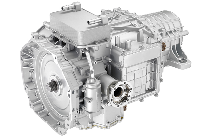

Some 2020 - 2021 Corvette models may have multiple DTCs set in the Transmission Control Module (TCM). The DTCs may be caused by an internal transmission solenoid or switch sticking due to debris in the DCT TR-9080 transmission (RPO M1L). (Fig. 20) Based on the DTCs that are set, GDS2 should be used to perform the appropriate solenoid cleaning procedure.
