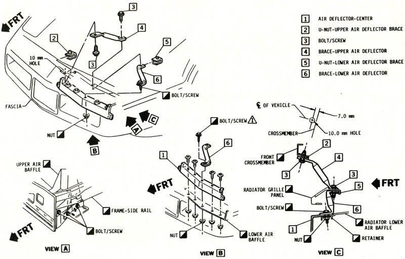

Comments that the front air deflector (dam) gets damaged by bumps, curbs and snow piles may be received. A service kit with two new braces has been released to address this situation on affected vehicles.
This condition can be addressed by installing the braces per the illustration and instructions provided in the service kit. The part numbers for the service kits are as follows:
| Model Year | Service Kit, Part Number | Application |
| 1984-85 | 10107825 | All Vehicles |
| 1986 | 10107824 | All Vehicles |
| 1987 | 10107824 | For Z51 Option |
| 1987 | 10107825 | For Base (W/O Z51) |
