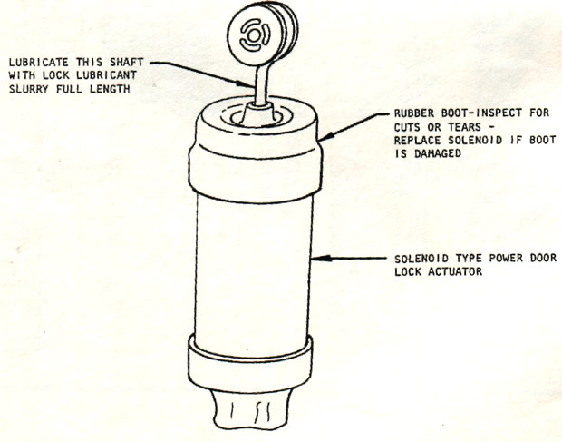

  6. If unit is equipped with power door lock system using solenoid actuator as shown in Figure #1 (all 1976 styles and 1977 "f" and "X" styles), inspect rubber boot at top of solenoid for tears or cuts.  If boot is intact, lubricate solenoid shaft with lock lubricant slurry.  Take care not to damage solenoid boot during removal for inspection and shaft lubrication.
    NOTE: Do not lubricate solenoid below boot area of solenoid shaft.
