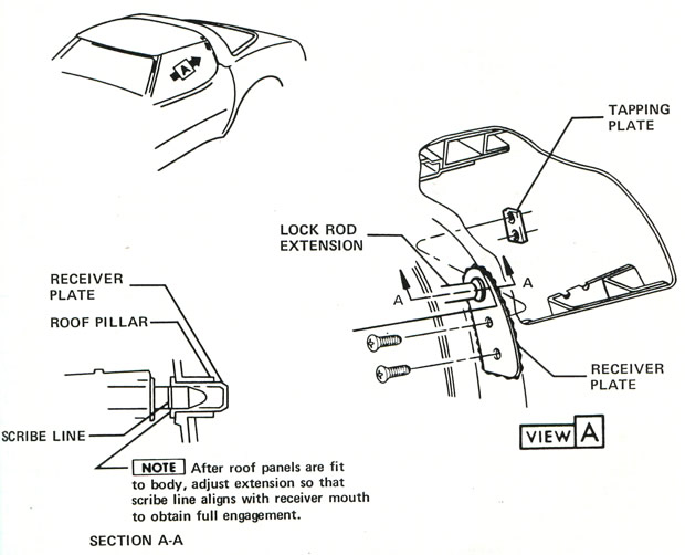

- Remove the roof lock receiver plate screws. Hold the tapping plate, located behind the roof pillar, to prevent it from falling (see illustration on page 2). Remove any excess sealer from pillar and receiver plate.
- Using a small round file, elongate (lower) the three holes in the roof pillar as required to obtain a relaxed roof panel with a flush fit. This will be a trial and error process of installing the receiver plate and checking that the roof panel lock rod extension engages easily.
