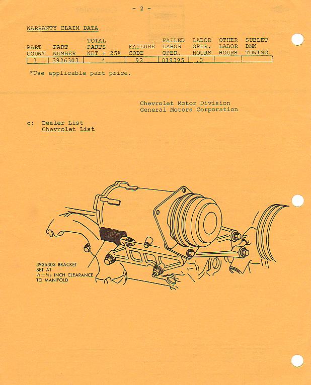

1973 Corvette: Service Bulletin: Exhaust Manifold Heat Shielding Estimated Reading Time: < 1 Minute 132 July 6, 2014 AC, Heating and Ventilation, Engine - Drivetrain 0 3.26K Below are the attachments for this service bulletin.
