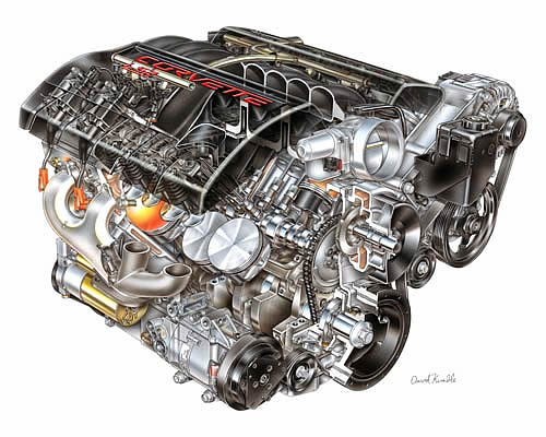

    Click image for larger view
    More torque, more power, more refinement, same fuel economy and better emissions. That's the LS2.
    Image:  David Kimble/GM Communications
