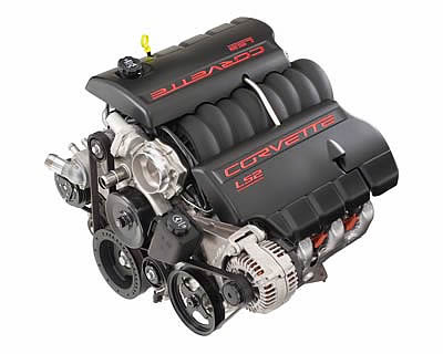

    This is what 400hp looks like. Not much different that a 350hp LS1 but, boy, there'll be a difference in feel!
    Image:  GM Communications
    It's interesting GM Powertrain is trying lower piston ring tension because that's part of what got GMPT into trouble with Gen III. High oil consumption by some '97-'01 engines was eventually fixed under warranty with a higher tension oil ring expander and a new second compression ring. It will be interesting to see how low tension rings work-out this time around.
    GM seems to be giving-in to the whiners who believe cold piston knock is actually a problem. Turned into a massive "piston slap flap" by Internet conspiracy theorists masquerading as experts, cold piston knock is usually an minor annoyance which goes away a few minutes after start-up. Nevertheless, going to full-floating pins may help address cold piston knock but, more importantly, it will enhance reliability/durability when the Gen IV is released in a high-performance, LS7 version.
    The block oil galleries were revised to supply oil pressure for the special valve lifters and other hydraulic devices which make-up the Displacement on Demand (DoD) system. The knock sensors were moved to make room for DoD hardware. At this point, those changes are of no consequence. The Corvette does not use DoD because of a structure resonance problem which makes it obvious the engine is running as a four-cylinder. The six-liter's, 5.3-liter GEN IV cousin (due in '05 in mid-sized SUVs) will use DOD, so, in the interest of efficiency at the foundry; all Gen IV aluminum blocks have the same oiling system.

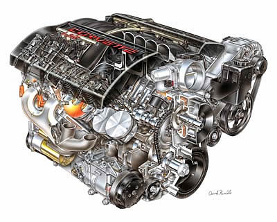

    Naked and exposed, this is what one of the most efficient high-performance sports car engines in the world looks like.
    Image:  GM Powertrain
    One of the biggest, late-development challenges in taking the LS1 to production back in the mid-'90s was getting reliable oil pressure at high rpm and maximum lateral acceleration. A result of work done to that end was C5's so-called "batwing" oil pan. During the LS2 development, engineers obtained reliable oiling with a "standard" type oil pan and a quart less oil capacity. GM offered no specifics of this new pan other than saying it comes "...with cast baffling, has reduced mass and provides superior oil control." Time (on the race track) will tell.
    The new heads use the same valve sizes and port configurations of the LS6. A six-liter Gen IV gets within 100 rpm of the LS6 without the LS6's hollow stem valves. Almost 11:1 compression is just short of amazing on pump gas, especially the 91-octane (rather than the recommended 93-octane) which is all you can get in some parts of the country, especially out West. No doubt, when running 91 on anything else but a cool day, the engine controls will rely on knock retard (and the toll it takes on performance) to keep the engine out of detonation. Like the LS1 and LS6 before it, we suspect LS2 will take 93.5-to-94-octane to eliminate knock retard under all conditions.
