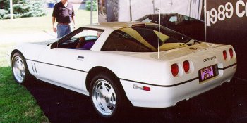

I ran a weight distribution test on 6 September, 1989 with a 1989 ZR-1 prototype.  The baseline curb weight was 3469 lbs. and it ran the 1/4 mile at 13.05 @ 110.7 mph and 0-30 mph at 1.92 sec. (not one of the better '89 prototypes!).  I added 300 lbs to the car:  1) under the headlights  2) in the passenger seat and  3) in the rear of the storage area.  Here are the results:
Test Weight Distribution 1/4 Mile 0-30 mph
+300 lbs. in front (57.4% of total curb wt.): 13.30 sec. @ 109.8 mph 2.04 sec.
+300 lbs. in center (53.9% front): 13.23 sec. @ 108.9 mph 1.98 sec.
+300 lbs. in rear (46.9% front): 13.14 sec. @ 108.6 mph 1.85 sec.
Photo of a white, 1989 ZR-1 prototype.You'll probably note the mismatch of 1/4 mile speeds with the rest of the results.  I didn't do anything to verify this, but I suspect it results from better aerodynamics with the front end closer to the ground.  Bottom line:  about 0.15 seconds between condition 1 and 3, but a world of difference in the behavior.
